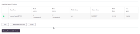

RAXE500 -Readyshare- Network Drive Add Issue but access the Drive Over Internet
Hi All, I have been using an SSD connected to the USB 3.0 port of my RAXE500 router (Firmware Version V1.0.12.96_2.0.45) and was previously able to: Access it via FTP from outside my network. Add...

Since I don't want to use the Router IP and More Inclined to the \\readyshare\ path
Router Login>Advanced>USB Functions>ReadySHAREStorage>USB Storage (Advanced Settings)
Network/Device Name: I changed readyshare to readyshares
I am able to access the network driver on the wifi + FTP as well.
