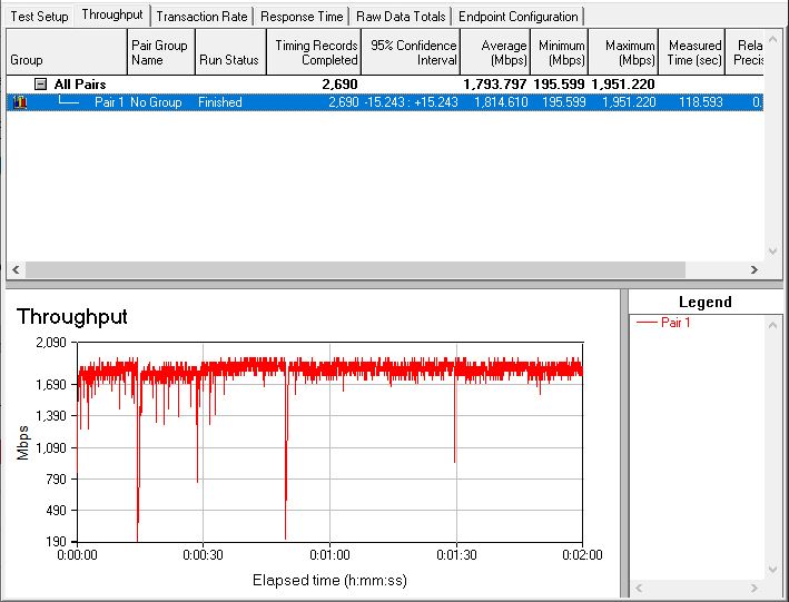

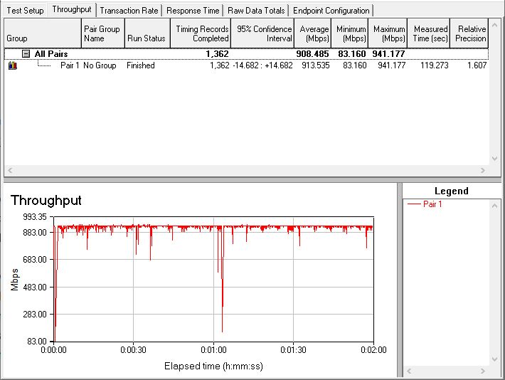

Beyond that, while it takes a while for embedded images to show up on the forums, usually to tell when speeds are being capped either by software settings or a bottleneck on one of the endpoints, you will typically see speed results like this, showing speeds being capped artificially.
Then when there are no artificial limits on the AX210, the results should look similar to this.
