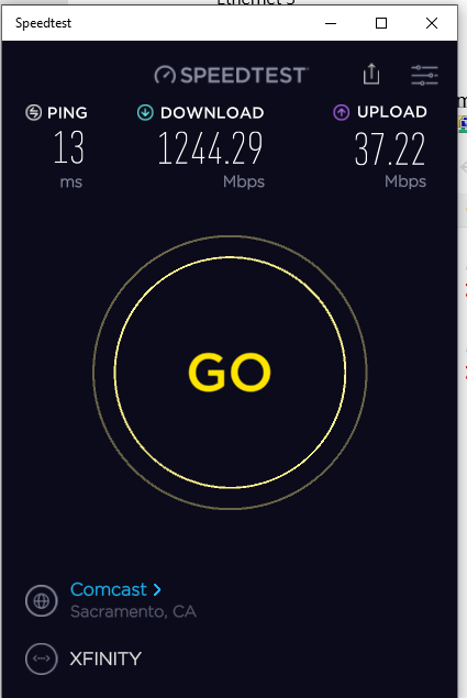

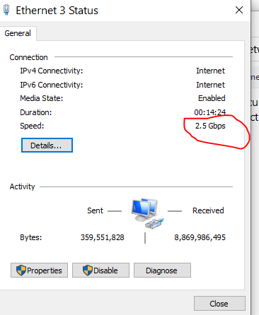

My Xfinity speeds just went up from 1G to 1.2GB. If I test my speeds hooked up to the RAXE500 Router it still only gives me the 1G. If I go straight to my Netgear CM2000 Modem I get the 1.2G. Plus my Lan shows only 1G under properties when hooked up to the RAXE500. When hooked up directly to the CM2000 Modem only it shows a 2.5G connection. I set the Router interface set to the 2.5G and plug into the 2.5G Port, but still only get 1G and my Laptop connection shows only 1G. Can this be fixed with firmware? I'm using a Killer E3100 USB-C 3.1 to RJ-45 2.5Gbps Ethernet Adapter on my Laptop to get these new speeds. The photos below are when I connect from the Modem to the Killer Nic directly, no RAXE500. These are what I should see if connected with the Router, but instead I am getting the 1G bottleneck. Please advise.

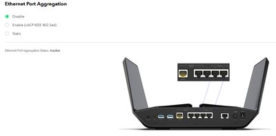

The RAXE500 has 1 2.5GbE port as well as 4 1GbE ports, where 2 of them can use LACP to provide 2Gbps.
If your ISP is able to truly deliver on the 1.2Gbps speeds, then the only wat to get it, is to set the 2.5GbE port on the router to act as your WAN port. and then for your PC, either install a NIC that supports LACP, or use an 802.11ax WiFi adapter which can get real world throughput in the 1.7-1.8Gbps range over WiFi on the 5GHz band.

It's Lan connected with a Killer E3100 USB-C 3.1 to RJ-45 2.5Gbps Ethernet Adapter. The Adaptor gets me over 1.2G when going straight from the CM2000 Modem. The Nic properties also shows 2.5G. Once I hook up the RAXE500 it drops down to 1G and the Nic properties shows only 1G. I have the RAXE500 internet set at the 2.5G and have the Lan Cable from the CM2000 Modem to RAXE500 plugged into the 2.5G Port.

With a completely wired setup, you will not be able to get 1.2Gbps with your current setup. the reason is because the router only has 1 2.5GbE port, thus you cannot have both your laptoop using a 2.5GbE adapter, as well as the 2.5GbE connection from the modem. The rest of the ports are either 1 GbE max, or 2 gigabit if you have an adapter that does teaming such as LACP. Your current adapter does not support LACP as it is a single Ethernet jack device.
Because of those limitations, you will end up with a 1GbE bottleneck unless you use an Ethernet adapter that has 2 Ethernet ports and supports teaming or LACP.The reason for this is is that you are currently ending up with one of 2 setups.
- You either have the model connected to the 2.5GbE port, and your USB ethernet adapter connected to one of the other Ethernet ports on the router which top out at 1 gigabit.
- The second scenario with your current hardware is the modem connected to the 1GbE WAN port and your USB adapter connected to the 2.5GbE port, buth the modem is now stuck with the 1 gigabit bottleneck.
Getting around the limitation:
- Use a WiFi adapter such as the Intel AX200 or Intel AX210. ($15-17 for AX200, and around $25 for the AX210)
- Get an Ethernet adapter that supports LACP (Often needs a desktop PC as they are often PCIe cards)
