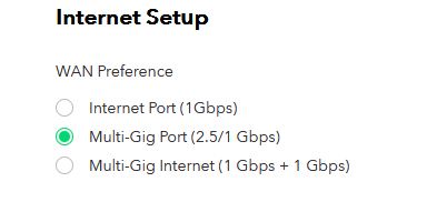

It seems like you still are not using the the 2.5GbE port on the router as the WAN port.
Iif you use the Yellow 1GbE WAN port on the RAXE500 then even with the AX210 it will not go over gigabit speeds because the WAN port is the bottleneck. if ou want the AX210 to give over 1 gigabit throughput, then you need to do the following.
- Head to the router web UI ( often 192.168.1.1 ).
- Click on the advanced tab.
- Go to Setup > Internet Setup.
- Set WAN preference to " Multi-Gig Port (2.5/1Gbps).
- Click on Apply.
- Connect an Ethernet cable from the Ethernet port of the cable modem, to the 2.5GbE port of the router.
- Once you have established internet connectivity, test the speeds, again, and it should offer speeds over 1Gbps.
- martyr444May 29, 2021Apprentice
That got my Intel AX210 to get a range from 600 and up to 1127MBPS. That's with everything within about 6ft of each other. Those speeds are not very consistent. I can only do this for testing purposes because it still cannot connect to the WPA3 Security. I have the 21H1 version of Windows 10. That part must be a Microsoft/Intel issue that may never get resolved.

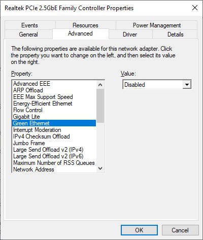

For the 2.5GbE port, if using a longer Cat 5e cable, then in your Ethernet adapter settings in device manager, and disable options such as "Green Ethernet", energy efficient Ethernet, and other similar functions.
or if you have any reliability issues, then disable those options, which will improve SNR on the Ethernet cable.
Most of those green functions attempt to save extremely tiny amounts of power by using timings to estimate the length of the Ethernet cable, and then reducing the output to lower levels to save power. The issue is that if any aspect of the cable is not up to standard for 2.5 GbE, or if it is a cable that advertises a spec but lacks proper shielding, will end up with a bad SNR which can cause reliability issues.

The standard power saving mode in terms of windows power management for the adapter is different from functions such as EEE, Green Ethernet and other 802.3az type functionality. Basically when below a certain length, (usually 50 meters), they go into their short reach mode and start cutting back on the power used to send frames. Sadly many switches and newer routers also support these functions and in turn will use it if enabled.
PS when terminating Cat7, make sure the braided outer shielding has some length left in tact for the grounding, and make sure the untwisted segment of the cable from the termination process is kept as short as possible, this is especially important if any green functions are on, since it bases everything on estimated length and simply assumes a near perfect conductor.
Also with solid core copper wire, if frequently moving them around, they will start to fail and cause many frame issues as compared to a cable with more flexible stranded copper.
