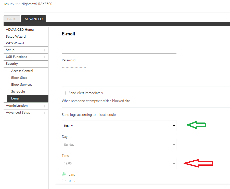

- FURRYe38Aug 27, 2022Guru - Experienced User
OK, I was able to reproduce this. Daily is broke and also notice on mine, when I set to Hourly, Day and Time options are grayed out:
I'll send this over to NG for review.
