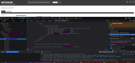

RAXE500 debug shows R8000 netgear router???
Hi All, Just wondering if anyone else has experienced this with the RAXE500 router. Since I purchased this router last year, I've had some major challenges with the Access Control feature. Ev...

Thanks, again! the suggestions did work but my hacker came back with an evil twin attack. My router's factory reset is not working properly everytime I reset, the 6ghz retains the same password that I initially set when I first purchased the router. so I reset the router, disabled my wireless settings and set up a dmz. So far, so good!!! It's not ideal, but at least I can get back to work.
