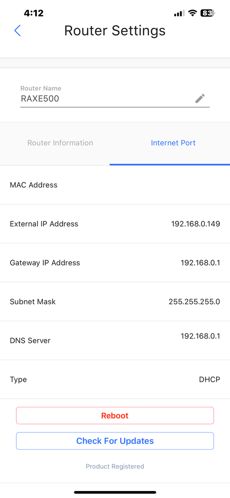

On the NightHawk app on my mobile device (both on Android and on iPhone), under Settings, Router Settings, Internet Port, it says the "Type" is "Down", so it's not reporting properly as I'm using the 5th port for Internet access and not the "Yellow" port. My device is setup for Access Point mode (see next potential bug below).
I did see this once, however, I had not put the WAN cable from my host router into the WAN port. After I moved the cable over to the yellow WAN port, the NH app reported the TYPE as DHCP:
This is Router Mode:
This is AP mode. Both seen in router mode and in AP mode.

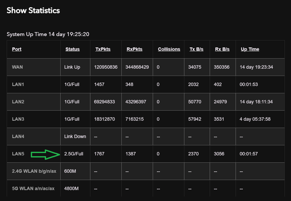

I have the RAXE500 connected to a Netgear M4250-12M2XF through the 5th port labelled multi gig, it will only detect it as a 1GB connection, I have plugged other devices that are 2.5G capable into the same cable and they all detect at 2.5G, etc. I set the 5th port up as the Internet port instead of using the Yellow port if that makes any difference in why I'm getting this bug.
I first tested the RAXE in both Router and AP mode behind a 1Gb LAN switch using the MG port:
I then tested the RAXE in AP Mode behind a CAX80 cable modem on it's MP Port: LAN5
And now currently with a NG GS110MX multi gig switch in between the CAX80 and RAXE.
Both configurations show 2.5Gb on the RAX500 MG port:
I did remember that to get the MG port to be enabled correctly for AP or Bridge mode, you first have to enabled the MG port on the RAXE while in router mode, once it's enabled there, then you can configure AP or Bridge mode on the RAXE and then connect it up on the MG port.

Thanks for this detailed analysis, I will reset to factory defaults again and try to make it work again, the key difference I see is this:
So somehow I didn't follow something write as my LAN5 (InternetPort) vs WAN(Multi-Gig Port) is different from you.
- rsun0525Sep 12, 2023Guide
So after moving the back and forth between the Internet port and port 5, it's now showing up as 2.5G, so now the last problem I have is once in a while the 6G band "dies" and doesn't accept any new connection, so only way to solve is to reboot.
