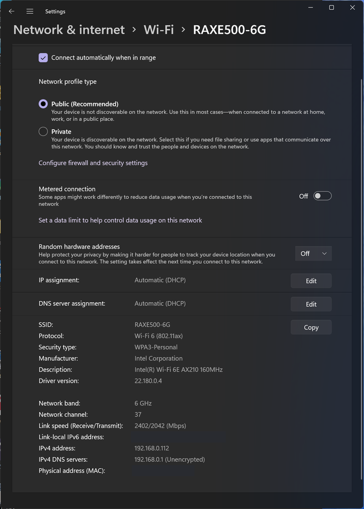

- FURRYe38Sep 12, 2023Guru - Experienced User
Been running my RAXE500 for past several days.
6Ghz still working.
Manual channel 37 for 6Ghz.
AX210 Intel PCI adapter in a desktop PC:
- rsun0525Sep 12, 2023Guide
Remember, I said existing connections would still be connected, it's new ones that can't connect and if my existing connection is disconnected, I can't connect back.
