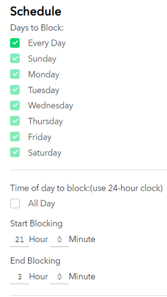

RAXE500 Schedule Not Working
What's wrong here? Yes, I hit apply. Yes, it is in 24hr format. Yes, time zone and DST are set. I also tried a suggestion of flashing the same version firmware. Hardware Version RAXE500 ...
Mar 23, 2022Guru - Experienced User
What's not happening? What are you trying to set here?
PM3
Mar 23, 2022Guide
Disable internet access for all devices in the time frame outlined.
I foster children and I know if I don't disable services overnight, they will be playing on the internet when they should be sleeping.
Thank you.
- FURRYe38Mar 23, 2022Guru - Experienced User
Do you have Access Controls enabled for these devices as well...
- PM3Mar 23, 2022Guide
I do not. I will look in to that. The directions only mentioned the Time Zone settings needed checked.
Thanks for the advice!
You can use Block Sites or Block Services with a schedule. I had to make multiple per device rules. This certainly could be made much easier if you could use Access Control and put in a schedule per device or selection of devices.
