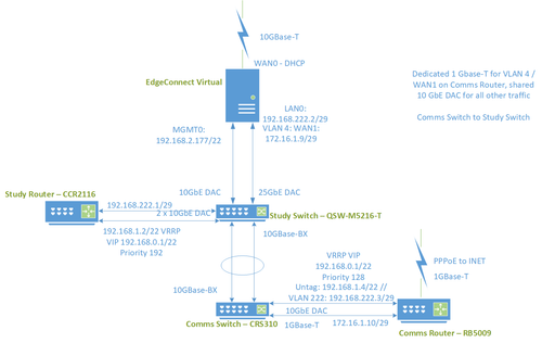

The issue is seen on all wired and wireless devices, phones, Mac, 2 Windows machines, both browsers and using the speedtest.net app.
The router isn't being a router, it's being an access point. The DHCP server is disabled and it's just talking to devices over WiFi then shooting the data over cable. 3 different cables, 3 different Ethernet ports on the device used, all connected at either 1 Gbps or 2.5 Gbps depending on which port they connected to.
The ONT is fine. The Internet connection is fine - it achieves over 8 Gbps wired via the same switch the RAXE is connected to but not going via the RAXE. It is connected to Comms Switch CRS310 and is using the EdgeConnect Virtual.
As mentioned a device connected to the Comms Switch via 10G optics hits 8 Gbps - the common point of failure is the RAXE whether wired or wireless. There is no shaping or rate limiting anywhere on the network that would impact the RAXE as I don't use it. Traffic going through the RAXE is seen the same way as everything else as far as the rest of the network goes, it just seems to not want to handle data flowing into it, remember it's downloads so the data is going from ONT into the RAXE then out to clients, at any kind of speed.

It isn't connected to the ONT. It has to go through 2 switches, a router, and an SD-WAN edge VM. The ONT is an ADTRAN 622v.
None of the intermediate devices care about the RAXE. They just see the client MAC address and IP address and that's it.
