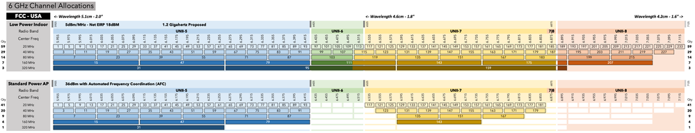

RAXE500 (WiFi 6E) - 6GHz channels supported
I would like to know how many of the 59 20MHz channels in 6GHz (UNII-5 through UNII-8) are supported by the RAXE500 WiFi router. The supported channels are not listed in the spec sheet.
Thanks!
  • The channels that it will allow you to select are:
    Channel 33
    Channel 37, PSC
    Channel 41
    Channel 45
    Channel 49
    Channel 53, PSC
    Channel 57
    Channel 61
    Channel 65
    Channel 69, PSC
    Channel 73
    Channel 77
    Channel 81
    Channel 85, PSC
    Channel 89
    Channel 93
    Channel 97
    Channel 101, PSC
    Channel 105
    Channel 109
    Channel 113
    Channel 117, PSC
    Channel 121
    Channel 125
    Channel 129
    Channel 133, PSC
    Channel 137
    Channel 141
    Channel 145
    Channel 149, PSC
    Channel 153
    Channel 157
    Channel 161
    Channel 165, PSC
    Channel 169
    Channel 173
    Channel 177
    Channel 181, PSC
    Channel 185
    Channel 189
    Channel 193
    Channel 197, PSC
    Channel 201
    Channel 205
    Channel 209
    Channel 213, PSC
    Channel 217
    Channel 221
    Channel 225
    Channel 229, PSC
    Channel 233

    • DevinAkin's avatar
      DevinAkin
      Many thanks Razor512! This is very helpful indeed.
      Do you have any insight on why channels 1, 5, 9, 13, 17, 21, 25, 29 are not supported within UNII-5?
      Much appreciated!
