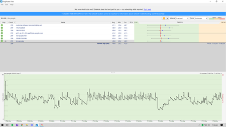

Router goes to 100% packet loss exactly every 5 minutes.
Issue started a week ago almost exactly. Drops internet for about 15 seconds every 5 minutes. I know it is a router issue as I have connected directly to my modem, used a different modem and even a s...

Starlinks modem. Tried older software still does it. Has to do with something with the router. It literally happens every 5 minutes for 15 seconds, as the pictures show. So it is 100% router related. Hoping someone else has come across the issue.
