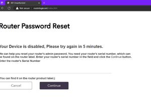

Router Password Reset>Your Device is disabled, Please try again in 5 minutes.
I am keep getting same warning about Router Password reset? Factort reset didn't help, I have tried .96 and .94 Firmware, same warning when I try to Log in. By the way This is new Router RAXE500

Fix was uninstall Network Adapter from Device Manager(Desktop) as well as remove Driver package from Add/Remove Program then restart Computer then reinstall Network Driver. Make sure you Power Cycle Modem/ONT(Unplug for 5 Minutes) prior to install new Router, and don't put any special Characters in Router Log in Password.

I'm having this exact same issue! I installed a new NG router and now can't connect to it via browser. It did update the firmware upon install, are you suggesting i go uninstall it? was that your fix? I assume it's trying to connect to the old ng router I had =/
