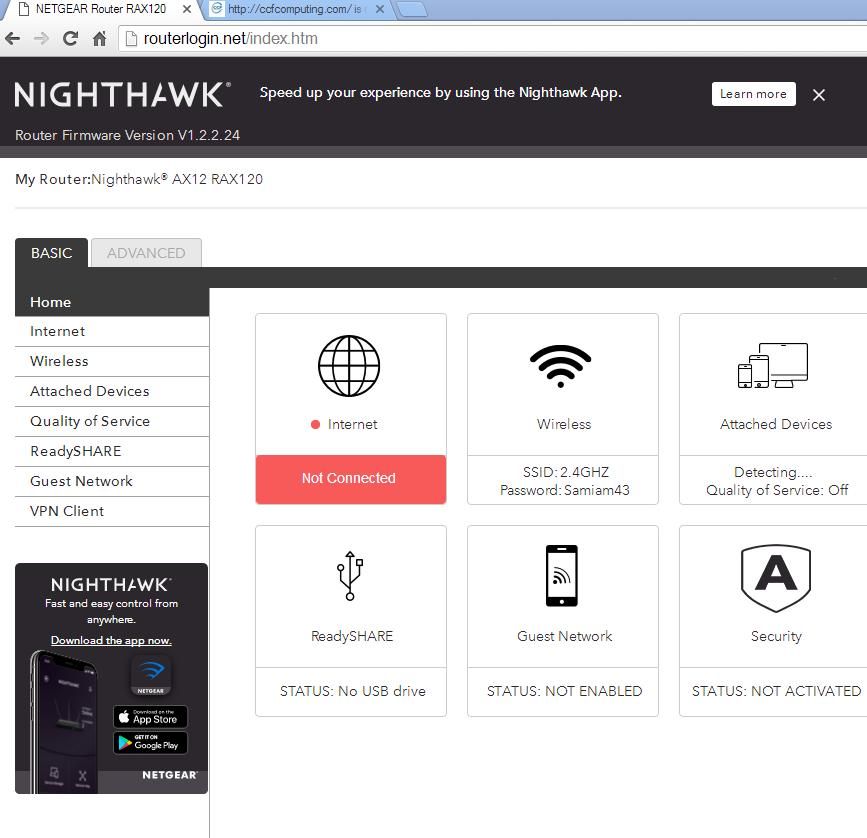

Setting up Netgear NightHawk AX12 AX6000 RAX120 to Wirelessly Connect to Motorola DOCSIS 3.0 (Bridge
Setting up Netgear NightHawk AX12 AX6000 RAX120 to Wirelessly Connect to Motorola DOCSIS 3.0 (Bridge) I would like to just enable the NightHawk as a grange extender but it would not hurt to al...

Sep 24, 2021Aspirant
That is what I want but it is not working

- nocincSep 24, 2021Aspirant
I have read all of these pages before, also they are not specific to my routers.
Thank youf or replying, and I agree, I do want to go static and would like to set it up manually.
I am more concered with JUST having my router get connected, I can do the rest fromt here
