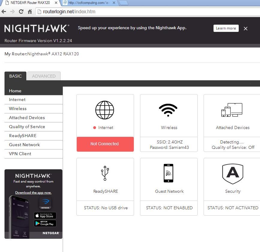

Setting up Netgear NightHawk AX12 AX6000 RAX120 to Wirelessly Connect to Motorola DOCSIS 3.0 (Bridge
Setting up Netgear NightHawk AX12 AX6000 RAX120 to Wirelessly Connect to Motorola DOCSIS 3.0 (Bridge) I would like to just enable the NightHawk as a grange extender but it would not hurt to al...

I have read all of these pages before, also they are not specific to my routers.
Thank youf or replying, and I agree, I do want to go static and would like to set it up manually.
I am more concered with JUST having my router get connected, I can do the rest fromt here

Sorry for the second image, it was not showing the first time. I am new here, is there a way to edit or delete posts? (I do not think so)

For your router, you will need to do the following to set up a wireless bridge.
Go to Advanced> Advanced Setup> Wireless Settings.
Then scroll down and check the box that says "use other operation mode".
Check "Enable Bridge mode".
Then click on "setup bridge mode wireless settings"
Once you have done that, it should open a new window where you will select the band from the dropdown list, and then you will enter in the SSID and password and security mode exactly as you have it set on the main router (all case sensitive with no room for error).
Once you apply those settings, the router will restart and attempt to connect to the main AP.
The second WiFi router will then essentially behave as an unmanaged switch for wired devices connected to it. It will not allow WiFi clients to connect to it, and for some reason Netgear doesn't allow the unused band to become an AP either.
PS, the wireless bridge mode tends to have higher throughput than the extender products since all of its air time is dedicated to being a client, and it is often a 4 stream radio.

Thank you all for replying however I have tried all of these things.
People are giving me basic information, I have called netgear and they say it is not possiable to connect wirlesslesy however then why does bedige mode ask for wifi info to the main router?
I would like someone who has actually done this with Setting up Netgear NightHawk AX12 AX6000 RAX120 wirlessly to their modem.

That is rather strange since it is a functionthat Netgear has not changed in many years beyond the most basic for supporting new standards such as 802.11ax. Beyond that the UI has not changed in the past 10 years or so but in my experience it has worked reliably.
I typically use the wireless bridge on nearly all of their routers when testing performance since no one seems to make anything higher than a 2 stream adapter, but many WiFi routers will have a 4 stream radio.
- Razor512Sep 25, 2021Prodigy
Wanted to also add that if the correct bridge mode is enabled, the web UI will change, and DNS address as well as the default IP will no longer work. The router will have an IP provided the main router, and the UI will look very different. The basic page will have most options disabled, (including all AP related settings), and the advanced tap will just have client info such as the IP, link rate and various other common settings.
In your case, it will look close to this when the settings are applied on both the popup window and the advanced page.

That would be fine as long a I can JUST get the internet status set as GOOD
