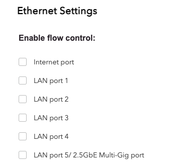

Slow download, normal upload, sending TX pauses though flow control off
So the switch in the RAXE500 I have here seems to be malfunctioning. The router is being used as an access point,the issues persist whether used in AP mode or as a router. It is unable to achieve...
- Mar 19, 2023
Some more work has proved beyond doubt that there's a pretty big issue with how the device handles links of different speeds. This is really not good for a device with a single 2.5G port, 4 1G ports and WiFi that's easily capable of over a gigabit.
So I pulled it out of the network and replaced with an older Netgear that has the exact same issues but that's another story.
Connecting it via a cable to the network via the 2.5G port, and a gigabit port to the computer causes slow download due to pause frames sent by the router on the 2.5G port to the actual router handling the Internet connection.
Connecting via a cable to the network via the 1G port and 2.5G port to the computer causes slow upload due to pause frames sent by the router on the 2.5G port to the computer.
Connecting to the computer and the network via 1G ports all is fine.Connecting to the network via the 2.5G port and using 6E WiFi causes slow download, correct upload - the WiFi is slower than the 2.5G port so pause frames are being sent down the 2.5G port by the Netgear.
Router mode, having the Netgear NAT which I don't want it to do, all is normal. The device doesn't work properly as an access point and can't handle different speed ports via its switch making LAN to LAN transfers problematic and access point mode pointless.
I'm taking this up with their Gearhead support tomorrow which should be exciting.

FURRYe38 wrote:What is the Mfr and model# of the host router the NG router is connected too? Mikrotik CCR2116-12G-4S+
Be sure your using a good quality LAN cable between the modem and router. CAT6 is recommended. Are you using the 1Gb LAN port or the Multi Gig Port for the connection to the main host router? The 2.5G link is error-free apart from the flow control pauses coming from the router.
Any LAN switches in the mix between the RAXE and host router? Yes. I'm seeing the inappropriate flow control arriving on one of them, however it also impacts directly connected hosts if Ethernet port speeds aren't the same. As in straight across the router between ports.
What devices are you speed testing with? Several.
Wireless and wired speeds same across all devices? Yup.
