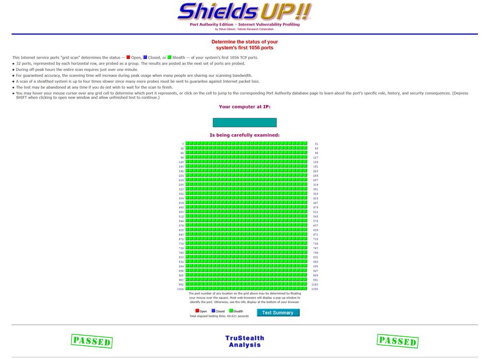

OK so updated my RAX50v2 to recent FW version.
Factory reset and setup from scratch.CAX80 in modem mode.
PE is enabled by default. Testing with it enabled and disabled:
PE Enabled:
PE Disabled:
I Noticed that the testing site was being reported as flooding the logs:
[admin login] from source 192.168.1.2, Wednesday, Aug 06, 2025 15:39:37
[admin login] from source 192.168.1.2, Wednesday, Aug 06, 2025 15:39:33
[DoS attack: TCP SYN Flood] from source 4.79.142.206,port 45743 Wednesday, Aug 06, 2025 15:39:03After I logged in at 15:39 and disabled PE and re-tested again after that, logs didn't report any flooding from the test site.
I recommend that after you disable PE and re-test, have your ISP give you a new WAN IP address as I presume some nefarious items may have a target for that WAN IP address. Once you have PE disabled and a new WAN IP address, I'm hoping you shouldn't see issues continue.

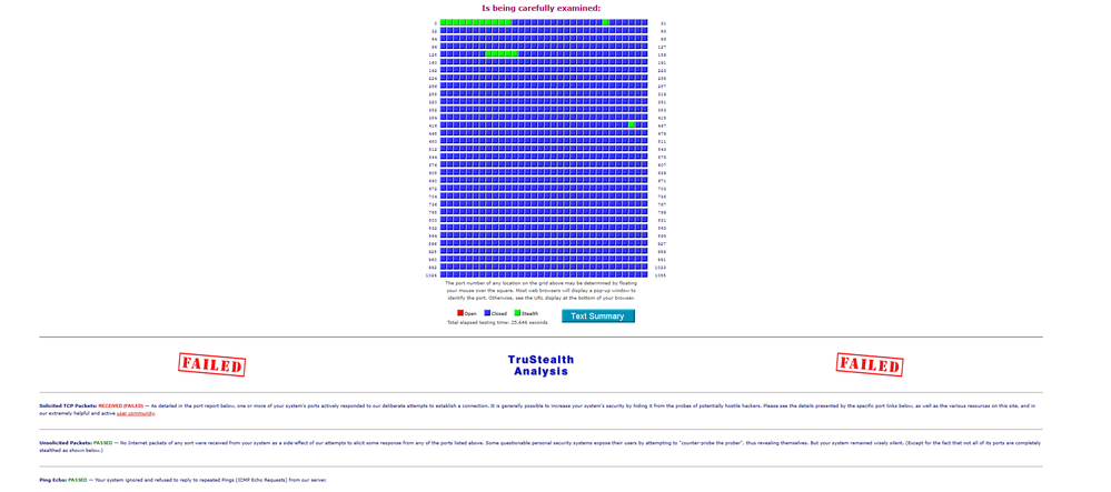

When you tested ShieldsUp and PE disabled, did you first disconnect all ethernet devices from the router accept for the one test pc and then disable the wifi radios on the router prior to testing?
Please post a screen capture of the test results from all serivce ports testing.

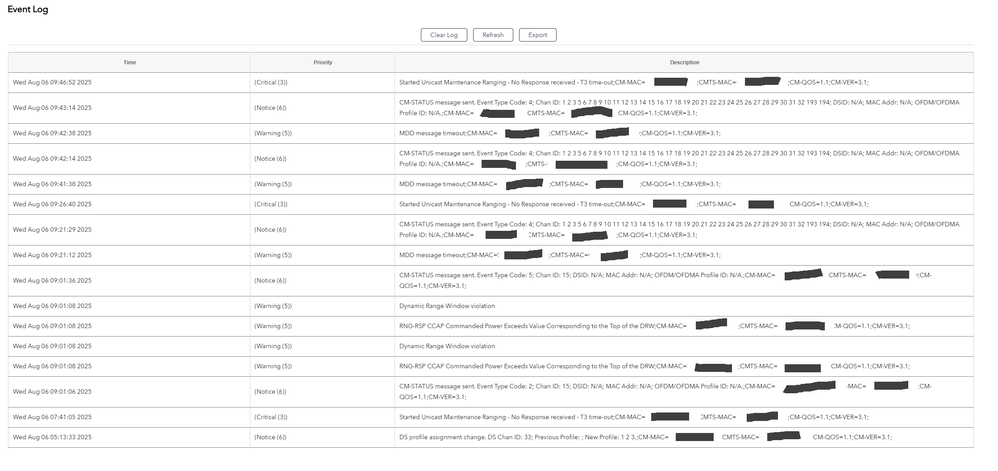

Please post a copy and paste of the modems connection status and event log page.

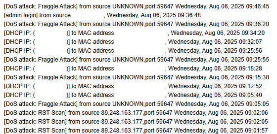

I got into my router and still getting SYN floods, RST scans and DoS fraggles. (This is just a portion)
I also got my modem logs, i dont understand them but here they are. (Redacted any MACs)
After all of that, i STILL have most everything CLOSED and not stealthed.

Please post a copy and paste of the modems connection status page.
https://kb.netgear.com/30007/How-do-I-obtain-the-cable-connection-information-from-a-NETGEAR-cable-modem-modem-routerAny Criticals, Errors or Warnings seen in the event logs needs to be reviewed and resolved by the ISP. Indicates a signal issue on the ISP line up to the modem.
Is Armor installed on the PC and enabled on the Router?
Try disabling Armor all together on the router and PC then re-test again. All those post should be stealthed and not closed.
