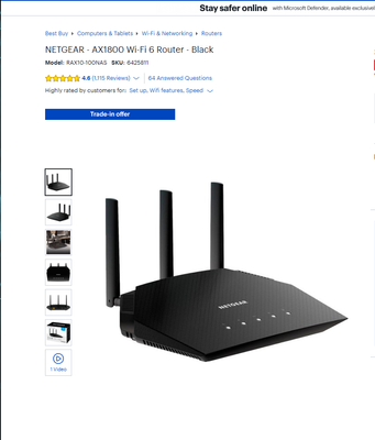

    Edit:  Your new devices are a model RAX10.  The images were approved so I can see them.

    What actual device do you have? AX1800 is a speed, not a model.

        Sorry my link was removed.. This is the router I am trying to setup in new buildings
