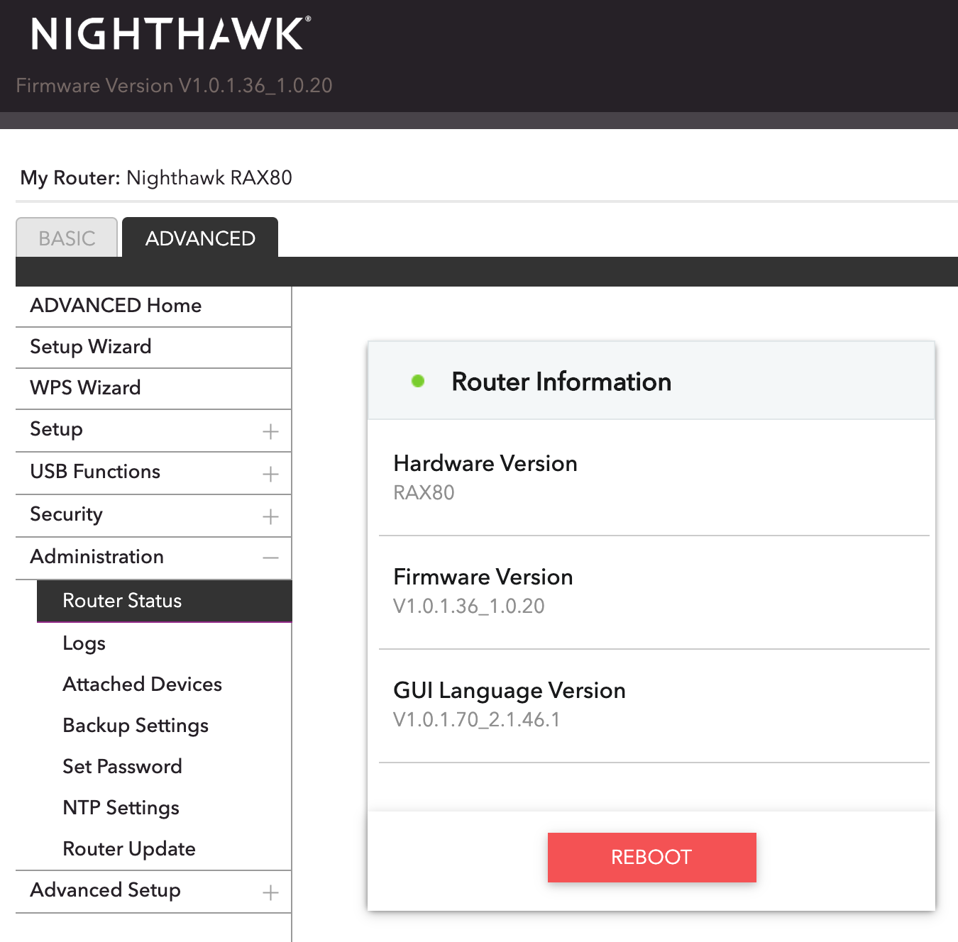

WowMeEvents
Mar 09, 2020Star
Rebooting screenshot.
I did reset it...software and hardware.
WowMeEvents
Mar 09, 2020Star
Screenshot after the firmware update and reboot.
I've tried upgrading and downgrading.
In fact, I've tried every firmware version available on the site. None of them 'take'.
