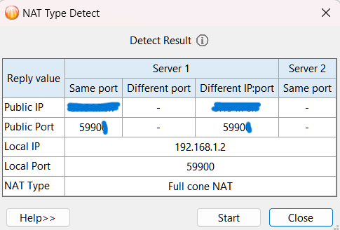

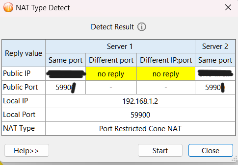

UPnP broken in Netgear RAXE500 on firmware 1.2.13.100, works on 1.0.12.96

As the title suggests, there seems to be a problem with the ongoing firmware at the time of writing this, which is version 1.12.13.100.
The firmware has difficulty forwarding ports using the UPnP protocol with Windows apps and Android. I'm not sure if this has already been reported.
I had to revert to firmware version 1.0.12.96 to get the UPnP working.
I'll attach some screenshots for your reference below:
The image below is when using the firmware version 1.12.13.100 (Port Blocked)
The images below are when using the firmware version 1.0.12.96 (Port Opened)

Had a factory reset and setup from scratch been performed to check this?
- sachbTutorYes, before reverting to the previous version of the firmware, I performed a reset using the button on the router just to check if it wasn't some glitch.
