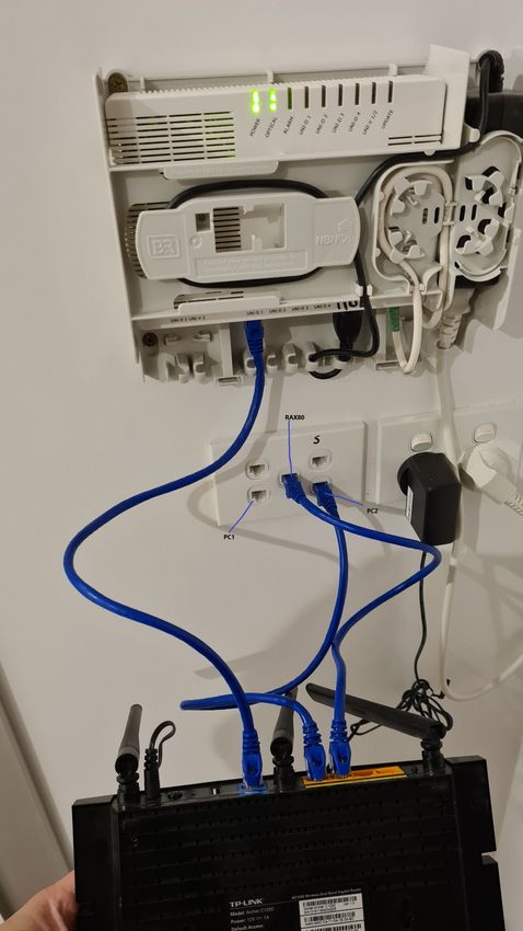

  1. NBN connects to Modem with PPOE internet connection
    1. Port 1 - PC 1
    2. Port 2 - PC 2
    3. Port 3 - RAX80 that detects no internet connection
      1. Wireless device
      2. Wireless device
      3. Wireless device
      4. Wireless device
      5. Wireless device
      6. Wireless device
      7. Wired device
      8. Wired device
    4. Port 4 - Not used
    5. Port 5 - Not used

      That is exactly what I'm trying to do. I have the NBN box with 1 working port sending data to a modem-router (TP-LINK) in Room 1 that has no WIFI enabled (broken). That modem-router sends data to 3 CAT6 wall jacks that distribute internet to 2 PCs in different rooms and the RAX80 modem-router in another room, that has 2 devices connected to it's LAN ports and the primary source of WIFI for the apartment.
      My problem is when I connect a cable from the ethernet wall jack to the RAX80 WAN port I get no connection. I assume I have to change something here in the RAX80 settings but I've researched and don't understand what I need to do.
      Photo for more context.
      Network
