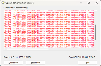

So I am thinking my modem/router is blocking port 1194. That might be the issue. I do have port forwarding turned on for that port though.
All i see is the reconnecting message. or a connecting message and nothing ever seems to happen?
- KitsapSep 07, 2023Master
Upperdeck wrote:I took a leap of faith that it might be working, but I have no idea
I modified the client file it created with my outfacing IP? I think thats correct?
Is there really no password and its just using certificates?
The VPN server uses the certificates plus the serial number of the router encrypted in the configuration files.
There should be no need to modify the configuration files generated by the router. You have to have your configuration set before you generate the files. If you change the configuration, you have to generate the files again.
I am not sure if what you are trying to do can be done. All devices on each network will not be able to see each other like the two networks were the same.
I do know the two networks you are trying to communicate between have to be on different subnets. They both cannot be on 192.168.1.1. There can be no IP address conflicts between the two networks. Recommend one be 192.168.1.1 and the other be on 10.0.0.1.
When you tunnel in to a network running a VPN server, the router assigns an IP address from the DHCP pool to the client device you used to initiate the connection.
- UpperdeckSep 07, 2023Aspirant
the file that the server creates does not use the IP that the device actually is on, it created the file using the 10.0 subnet but thats not the IP that the router sees. I dont see anyway to modify the file the server generates so it has the right IP.
