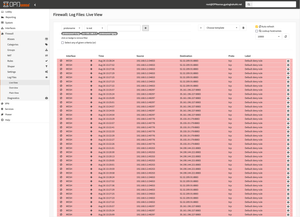

What is my RAX54 WiFi router connecting to at TCP port 8883?
I just set up my RAX54 WiFi router in AP Mode, and it is an OPNSense firewall behind it. Apart from the annoying ICMP attempts to Google DNS servers (which I believe is a bad practice to check if...

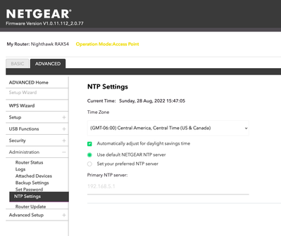

However, after changing the NTP settings to my own NTP server (the firewall), the router stopped trying to connect to those addresses at TCP port 8883.
So it seems, that "default NETGEAR NTP server" is not a standard NTP server, but some NETGEAR proprietary solution to sync time.

This is odd. I enabled the NETGEAR NTP server, and it works now, although I did not change anything on the firewall.
And I don't see connection attempts to TCP port 8883 either.
