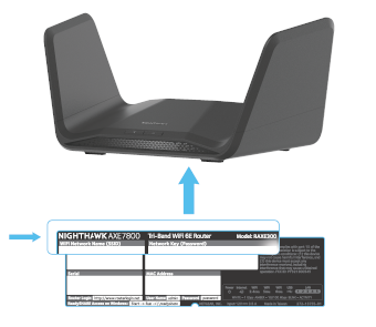

- michaelkenwardApr 03, 2023Guru - Experienced User
Kyloh3n wrote:
Hello apologies it’s for the nighthawk ax5400 6 stream wifi routr.That could be one of several Netgear devices. RAX50? XR1000?
Look at the label on the thing for the Model Number.
Model number label
