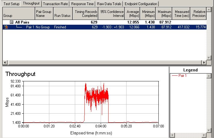

Usually if WiFi experiences a massive throughput drop at a random time, sometimes it can be due to interference, but that is extremely rare for the 5GHz band which is unlikely to get heavily misbehaving devices. In those cases, you can try collecting debug logs from the router to see if it reports any issue, though it would be very rare for you, especially since I have only encountered it once many years ago and that is in an urban area in NYC. The issue was some non-WiFi but very distruptve stuff on the 2.4GHz band that caused the WiFi router to use the lowest possible rate rather than do a ton of retransmission of frames. (likely someone in the ares using something that is very not FCC compliant).
In those cases while different APs will react differently, some can behave like seen in the attcched image.
Outside of that, an AP issue lke that will impact all WiFi client devices.
If it is just one device, then where may be some weird issue impacting performance to just that one device.
