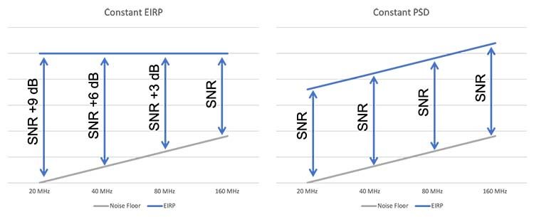

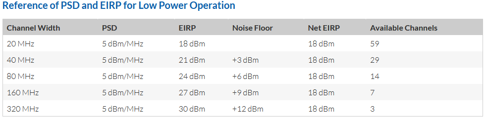

Which region are you in, and which channel is being used? While the 6GHz band is not too far off from the 5GHz band channels that largely operate in the 5.8GHz range. In some regions there are some draconian regulations imposed on the 6GHz band which forces the use of very low transmit. The impacts are made worse on many smartphones since they tend to use anywhere from -3 to -7 dBi gain antennas, while the router may use +3dBi gain antennas, and with beamforming can get a 5-6dBi directional gain, especially along the horizontal plane.
Due to the behavior of how they are mandated to manage transmit power, along with even stricter restrictions for client devices, if a home contains more dense building materials, then it can heavily attenuate the signal.
Currently the US is the least restrictive of the regions, but the restrictions are still quite draconian (Impacting all AP makers).
