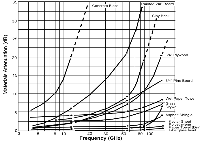

In cases like this, it is best to examine the building materials more closely. For example, it is just plaster, or is there a steel mesh in the wall supporting it?
One way to test is to use a WiFi analyzer app when you are in the same room, with the door closed, and then in 1 room over witht he door closed. The overall goal is to understand how much the wall is attenuating the signal.
Usually if there isn't much material to act as a faraday cage, then WiFI extenders can be a good solution. The issue comes when you have faraday cage like material in the walls. In those cases, while a modern Netgear WiFi router or AP will have some improvement since they consistently transmit near the FCC transmit power limits, and put a lot of R&D into optimizing the WiFI throughput over that range, there is nothing that can be done to provide a really good experience with a faraday cage. In those cases, you will need to either run Ethernet to the location where you wish to add an additonal AP (Nearly all netgear WiFI routers can be configures to work as a wired AP (same with their extenders).
