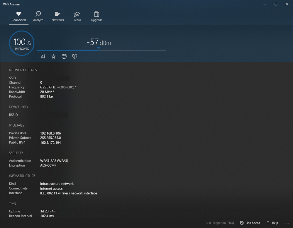

I can confirm with v1.0.1.52 and v1.0.9.72 that my Intel AX210 6Ghz PCI adapter (v22.45) install using Windows 10x64 is NOT connecting to the RAXE500 when WPA3 is enabled. I can connect the adapter to the RAXE500 if I disable WPA3 and set for OPEN security.
Same Intel AX210 adapter works on a different NG router with WPA3 enabled.
- FURRYe38Nov 17, 2021Guru - Experienced User
Adapter connected to NG non RAXE500 router using WPA3:
