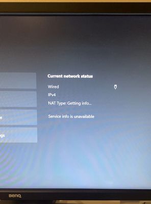

4. What error do you get when hardwired into the router on the xbox during setup? The xbox will read that it's connected but the NAT Type will be stuck at "Getting info..." and then the connection fails. It tries for about 5 seconds and then says "Not Connected" like there is no hardwire connection.
Then it basically goes into a loop of attempting to connect every 30ish seconds. I was able to get a capture of what it looks like for those 5 seconds when attempting to connect.

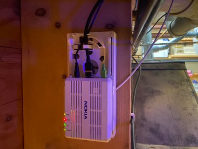

Here's a pic of it. I don't have time to dismount it from the wall but can do it later if you want to see the back.
- plemansJul 29, 2024Guru - Experienced User
Looks like standard nokia ONT.
