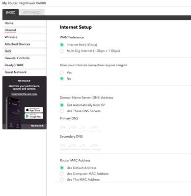

Jul 29, 2024Guru - Experienced User
Question, on the RAX router under the Advanced Tab/Internet section box, does the IP address show up as a 192 or 172 or 10 IP address or does it show a ##.##.###.### address?
When you configured PF rules, did you disable uPnP?

orkey41
Jul 29, 2024Tutor
The settings right now are Get Dynamically from ISP for the IP and the DNS
When you configured PF rules, did you disable uPnP? UPnP is enabled currently

- FURRYe38Jul 29, 2024Guru - Experienced User
Ok. If the RAX is getting a 192 address on the WAN port, means the ISP ONT has a router built in. This would be a double NAT (two router) condition which isn't recommended. This would be a double NAT condition which isn't recommended. https://kb.netgear.com/30186/What-is-Double-NAT
https://kb.netgear.com/30187/How-to-fix-issues-with-Double-NAT

No, thats the basic tab. I was asking about the Advanced Tab and the Internet section seen there.
Ok.
Internet Port should be a public IP address then. I'd confirm with the ISP that the ONT is in fact bridged or passing thru a public IP address to the RAX80. And not a private IP address.
