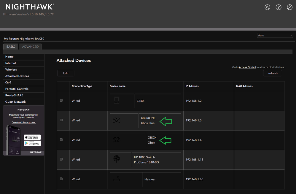

Jul 29, 2024Guru - Experienced User
Ok.
Internet Port should be a public IP address then. I'd confirm with the ISP that the ONT is in fact bridged or passing thru a public IP address to the RAX80. And not a private IP address.
I connected my RAX80 and got my two Xboxes connected. Both with OPEN NAT. Ethernet connected. CAT6
RAX80 is connected to a CM3000 cable modem here. Public IP address on the RAX80.
NAT Filter set to OPEN. I rebooted the RAX and hard powered OFF both Xboxes. After the RAX was back online, I powered ON the Xbox 1X and it got OPEN NAT.
I had to set a manual port on the Xbox Series X, then set it to OFFLINE for a few seconds, then back ONLINE, then the NAT status changed to OPEN.
Xbox One Device name is my Xbox One X
Xbox is the Series X.
