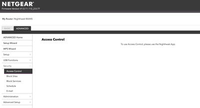

I'm actually accessing the router from my computer via a cable. Even under these conditions when I want to access the screen that allows you to block a device based upon its MAC address, the screen is not accessible to me. Instead, I'm told to use the app. Unfortunately the app does not allow you to block devices that are trying to connect but only allows you to work with connected devices using the Parental Control feature. I'm trying to find a way to disallow it from getting through in the first place.

Hello, Below is a screen shot of my router with the firmware version in the upper left.
I should begin by saying that I have found the offending MAC address and taken care of the issue. The only remaining issue is that I do not have the ability to block a given MAC address from a browser when logged into the router. As you can see below, its says to use the app. When I go to the app (version 2.18.0.2231 updated June 15,2022 I can not find an option to block a device by it's MAC address. You can however, block a device once it has connected to your router by using the Parental Controls.
I'm pretty sure this is not a modem related issue.
Thank you for your interest.
