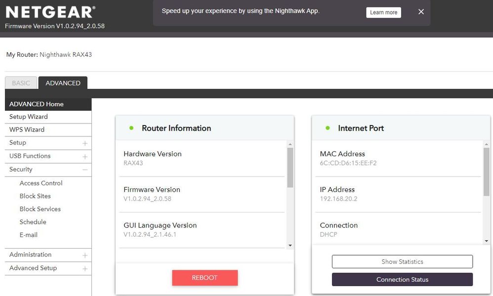

- IDraperJul 03, 2021Tutor
RAX43 - Nighthawk AX4200 (Not listed in model selection - a bit worrying as these are advertised as the latest WiFi 6 Netgear Router)
Nighthawk App and Web based Router access give no SPC tiles (Smart Parent Control)
Therefore the advertised benefits of Smart Parent Controls are non existent - ( outside of the promotional material )

- FURRYe38Jul 03, 2021Guru - Experienced User
Parental Controls are not seen anywhere in the routers web page? Maybe under Advanced Tab/Security or under Basic Tab?
- IDraperJul 04, 2021Tutor
I looked for this under security as directed by support, but there is no reference to SPC.
See attached screen dump:
- IDraperJul 18, 2021Tutor
For Australian support, you might like to send an email to salesANZ@netgear.com
They were very helpful and all matters have been resolved.
Smart Parental Controls are now working properly as well as Anywhere access.
