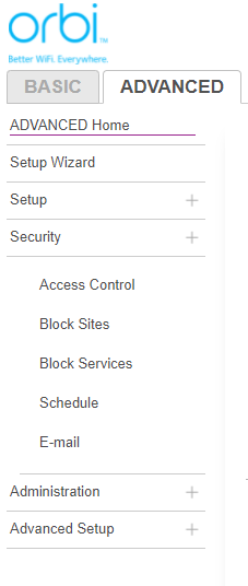

- Miguel20Aug 24, 2021Aspirant
No Parental Control option for me...
