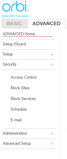

Whats listed under Basic Tab?
SPC will be seen under the Basic tab if and when it shows up.You might try this on this version of FW:
I had to do this once after accidently selecting the upgrade to SPC button incorrectly.

2) It took me a while to find it too.
If Advanced->Security->Parental Controls is visible it should have an option to convert to Netgear SPC.
3) Haven't investigated that, there is a phone app, check the linked pages there's probably info. there.
