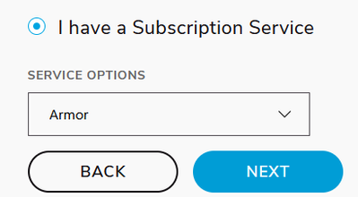

When you go through that support web site all the way to selecting the subscription SPC, does it indicate that there is an active subscription?
(I tried to make a screen shot of the pull down menu to show SPC at the bottom, but it closes before I can grab it.)
It allows me to select SPC and brings up this screen:
(Having never subscribed, that seems a bit odd, but what do I know?)
At some point does it show anything acknowledging that there actually IS a subscription to SPC?
Where any of those interactions with "Level 2" recent?
