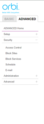

The options I see are as below . There is no ADVANCED > Security > Parental Controls.
Same with the mobile APP , I dont see and addons option under the Home Sandwich menu.

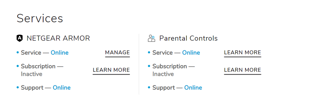

I checked the loggedin profile and mynetgear online and the email address and country and other details match.
I did see my old nighthawk devices and have unregistered them. I do see this below when i click on the router device in mynetgear but nothing other than this regarding parental controls in the app or in routerlogin.net

Smart Parental Controls is only seen and handled on the Orbi app. Won't be seen on the RBR web page.
