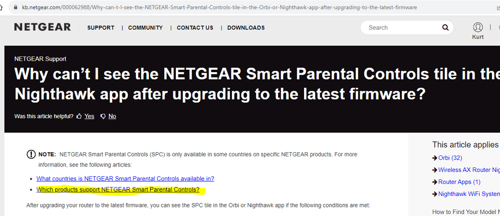

- schumakuSep 16, 2023Guru - Experienced User
terlu wrote:
I have the RBR350, and would like to use the parental control.
I have checked that I have the latest firmware on the router (V4.4.1.29_3.10.80). I have also checked that all the conditions listed in this article (https://kb.netgear.com/000062988/Why-can-t-I-see-the-NETGEAR-Smart-Parental-Controls-tile-in-the-Orbi-or-Nighthawk-app-after-upgrading-to-the-latest-firmware) are met.
Not checked the KB article good enough IMHO.
Even if trying hard, no RBR350/RBS350 or the like is listed on Which products support NETGEAR Smart Parental Controls?
SPC isn't part of the Data Sheet, QIG, or User Manual I'm afraid. Amazingly, no paid Netgear moderator was able to figure this out and reply accordingly since this and similar threads pop-ed up in the community.
Regards,
-Kurt
- terluSep 17, 2023Aspirant
Hi,
thanks for the reply. Obviously bad checking from my side here...
Terje
