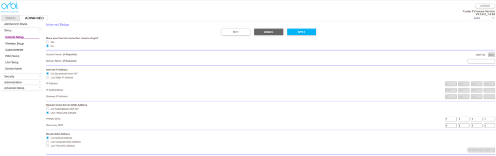

BenjaminNYC
May 22, 2022Apprentice
To use Access Control, please use the Orbi App
This is what I see when trying to access Access Control. I strongly suspect it's because accidentally activated the trial of Smart Parental Controls. Even though I've turned it "off" in the app, it's...

BenjaminNYC
Nov 18, 2022Apprentice
KevinLiT yes it tells me to use the Orbi app, which is one of numerous problems having SPC enabled on my account.
