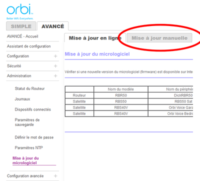

This selection:
and then select the satellite here:
Correct?

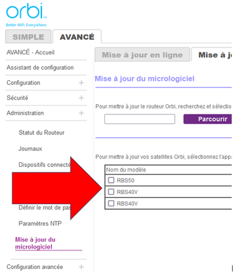

This selection:
Correct?
