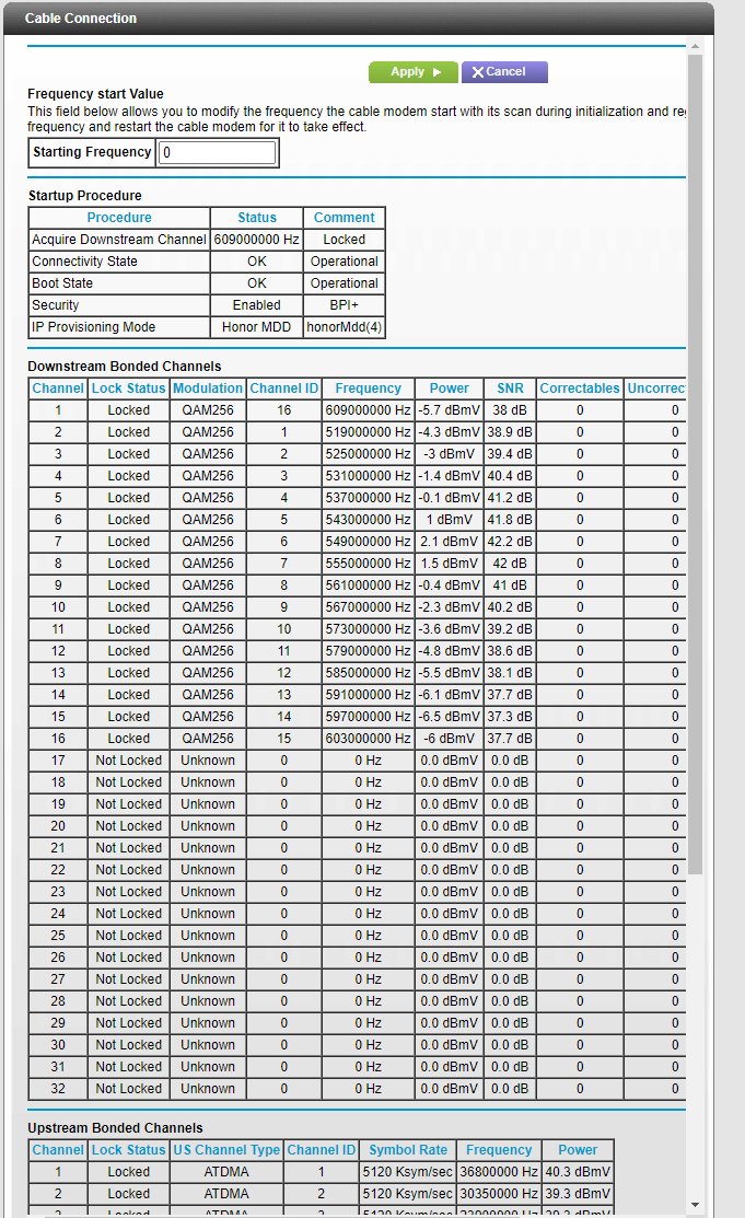

Bought the CM1200 about a month ago and since it was setup by RCN(isp) I have had it seemingly randomly dropping internet connection. When it drops connection the downstream light will be blinking an...

Your modem power levels are all over the place. the downstream channels should be within 3.5dbmv of each other. Yours are way out of this. Did rcn check the line?
Did you remove any splitters, amplifiers, or attenuators?
check the line for damage, kinks, old/bad/cheap connectors and cables.

RCN did check the line and they said they didn't see any issues with the power levels, but they seemed to just reference the levels on this page http://ny.speedtest.rcn.net// which just shows one number for each FwdSNR, Channel Pwr, and Transmit Pwr (not sure where it gets the number for these since there are multiple channels. Maybe its just the average). I did remember when internet was initially set up in my apartment the technician opened a panel in my closet that had some cables behind it specifically the line for my unit then a female to female connector that connects that line to the main room wall jack and another unused line that goes to the master bedroom jack. So I went ahead and connected the modem to the mainline coming into the unit (still using the female to female connector since the line in the wall doesn't go far enough). Power levels look marginally better (See attached) still not within 3.5dbmv. Will try connecting without female to female connector as well to see if that changes the power levels at all. Appreciate all the help.

Its getting better. MIght check further back up the line if possible to see if any other splitters/juntions. Or even take a look at the coax line ends to see quality. I've seen some pretty sketchy ones on apartment terminates.

Well the disconnect has happened a couple more times with the same errors since moving the modem to the line coming into the unit. I took a look at the coax end and it looked fine. At least no obvious signs of damage or corrosion. There aren't any other splitters or junctions that I can see and this is the line coming into my apartment so this is as far as I can test. RCN did test the line up until this point when they initially set up the service and didn't say there were any issues. The power levels still range from -5.5 to 3.3 which is quite a bit more than the 3.5dbmv range you had previously stated. Is there anything else I can do to improve the levels or do I need to go back to RCN with this info?
