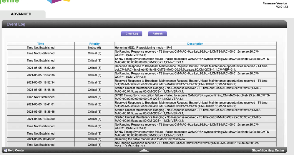

Thanks for prompt reply. Device bought in Feb 2021. Instability does not happen at the same time every day, nor at same frequency (some days, like today, 10+ reboots; others might be once a day)
id need to track down cable connections page / event logs. Have never done that before: possible to point me in the right direction?
plemans
May 05, 2021Guru - Experienced User
when you first log into the router, click on the internet icon on the screen. It'll take you to the cable connections page. Get all that info in a screens shot (might take more than 1)
to get the event logs follow this guide: https://kb.netgear.com/30008/How-do-I-obtain-the-event-logs-from-a-NETGEAR-cable-modem-modem-router
get screen snips as they're easier to read/interpret.
