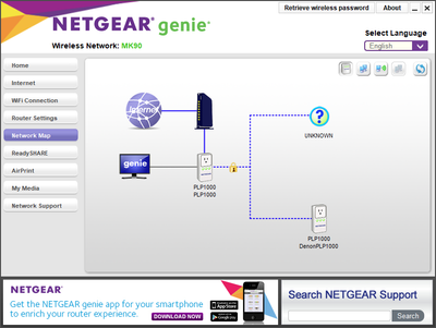

        One other thing to investigate is the Netgear desktop genie.
        Netgear is trying to kill this useful utility, but for the time being you can find it here:
        genie | Product | Support | NETGEAR
        Be warned that the genie installation file is wrapped up in a RAR archive that you have to decompress.
        If you look at the Network map on this, Powerline plugs should show up. This will let you check if the plug is in the network but with no active LEDs.
        Netgear abandoned its own Powerline utility years ago, so that's about the best you can get. Other brands do have their own control software that supports disabling and enabling sleep mode on plugs, but your symptoms don't seem to fall into that category. A reset should have turned that off.
