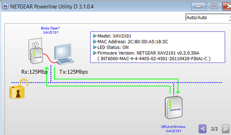

What do the RX:125 and Tx:125 mean? Are they the speeds the device is seeing? I have 100 coming into the house and my PC connected to the XAV2101 and speedtest shows only 30 or so. What's goi...

those are theoretical link speeds.
doesn't mean you'll hit those speeds as many things impact powerline performance.
I'd take a look at this chart: https://www.smallnetbuilder.com/tools/charts/powerline/view
it goes over tested powerline performance. Look at the speeds and the models hitting those speeds. the XAV2101v2 is a 200mbps powerline device.

Thanks, the chart shows a benchmark of about 40 so given I'm getting 30 or so, I guess that's not too bad. I was under the impression that if I had 100 coming in that the adapter might lose 10-20% of the speed, not 60%
Given the charts that show 60% loss, if I have 100 coming in and want close to that at my PC then I should be using one rated at 500 or so. Is that right?
- plemansDec 02, 2020Guru - Experienced User
roughly.
But at lot depends on your home setup. If you're home isn't condusive to powerline or has a lot of interference, it could be less than that even.
Many things cause interference and can lower powerline speeds.
