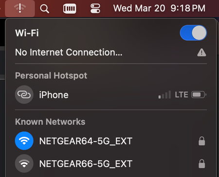

PowerLINE WiFi 1000 - Second PLW1000v2 wifi not working
I set up a PowerLine WiFi 1000 system to extend WiFi to a small office in our backyard. We've had no issues with it. I recently wanted to extend WiFi to our garage, so I purchased a second PowerLine ...

Hi, This almost looks like your new PLW1000v2 does not establish a powerline connection, due to different powerline keys. Probably you have the other new PL1000v2 also plugged to the AC power, and these two new devices are making up a new dedicated PLC network, and the LED make you believe it has a network connection?

The second PL1000v2 is not plugged in. There is only one PL1000v2 plugged in.

Have configured the Powerline Key or used the process with the [Security] button from the fine manuals?
P.10 from the Quick Start Guide might help:
- Sconnelly09Mar 21, 2024AspirantYes, I configured using the security keys. After doing so, the adapter indicated it was connected, but no internet via the WiFi. I reset the system, still experiencing the same problem.

Some security on your router prohibiting new unknown MAC addresses?
The computer adapter can just show the existence of eg. a wireless link established. In case for some reasons, the DHCP server can not assign an IP address over the connection data path, I would suggest to re-do the PLC security association, starting from a factory default (all the PLC devices), and then retry the Security button process.
