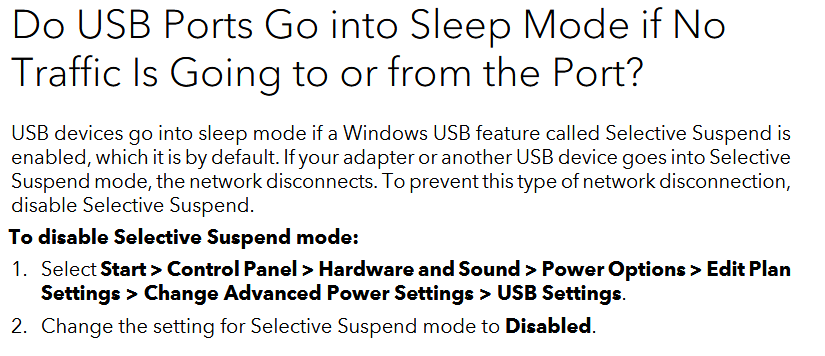

    Since the steps on page 12 of the User Manual failed to resolve the problem, have you checked this information on page 13:
    • BrickHeadSaysHi's avatar
      BrickHeadSaysHi
      Just tried that plus rebooting my PC (and waiting a minute to see if the light would come back on but that didnt really change anything. Speeds are still the same too
