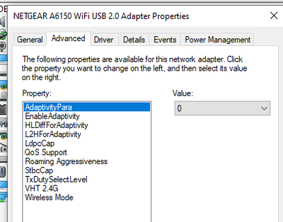

Thank you everyone for your help. It installed fine, but now I have a quick question regarding the values Under the advanced tab of the device.
I'm having not so good (-75db) reception with it. Anything I can tweak the above values to increase my reception quality?
Not really. That is down to the wifi source, the receiver and the local topography.
If you are in a separate room from the router, even the material in the walls will matter. Steel reinforced concrete is a great wifi absorber.
You haven't said what the wifi source is, which matters.
We now know which USB device you bought, the A6150. Given its shape and size, it isn't going to be the most capable wifi receiver on the market. It is AC1200 wireless. There are several USB adapters with better wifi specs.
