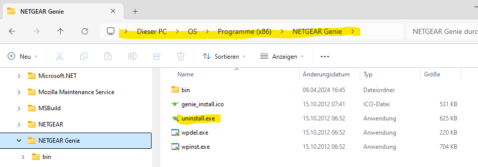

Very often, there is an uninstall application link at the same loction where those legacy programs are installed:

I dont have a netgear genie folder just a regular netgear folder and i can only remove it with help from the drivers itself
- schumakuNov 10, 2024Guru - Experienced User
If the Genie program was installed on your new Windows 11 system the files as shown almost certainly exist.
