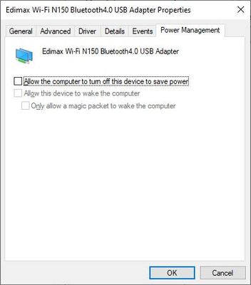

    You might also like to look for issues in Windows. They can also mess up an adapter.
    If nothing else, check that the USB settings for the adapter aren't set to allow it to go to sleep.
    Wifi adapter properties
    You don't want it to allow "sleep mode".
