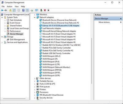

You could try cleaning up the USB devices connected to the PC. This entails removing old USB devices that are not longer connected.
Go into Device Manager. Look at Network adapters and View then Show Hidden Devices.
Wifi adapters
Then delete the unused drivers for your adapter.
